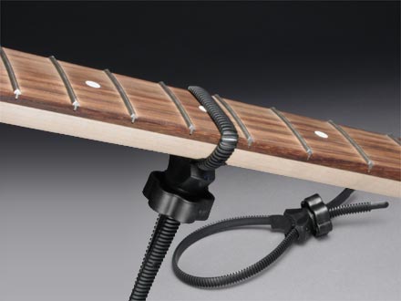

PostPosted: Wed Nov 22, 2006 2:50 am
I use these clamps. 6 of them and a cam clamp at the heel.
By the way you can get them cheaper at Walmart than at StewMac or LMI. Look for them in RV section of Automotive department
